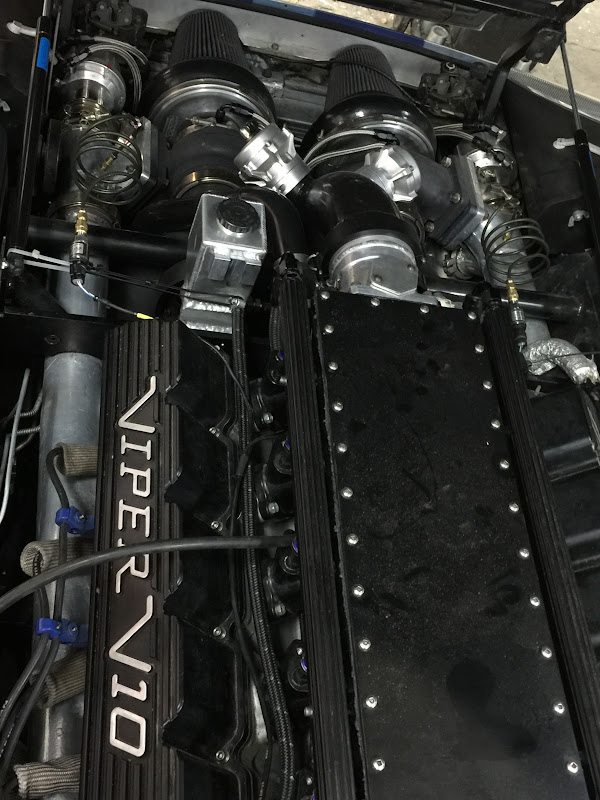

Car is coming along in this pic approaching completion.
I also drilled the logs for back pressure testing to monitor if the diverters were creating excessive numbers. The results were none at all and could probably get away with running a smaller turbine housing.
